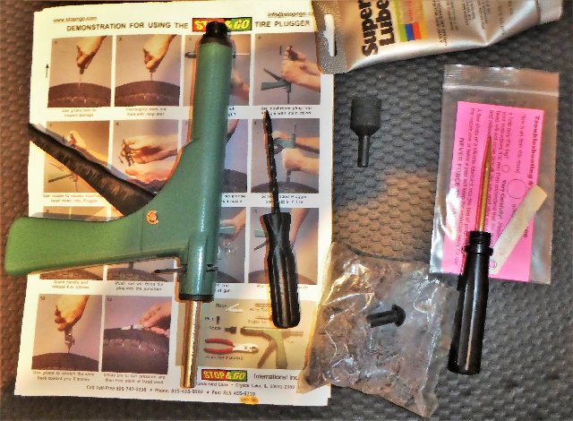

Rear, Mar 2015, Honda Forza300, Dunlop ScootSmart sliced by metal, required tow and new, up-sized, Pirelli, at the dealer.(no correct sized anything in USA!) $$$ Day!
Rear, Feb 2019, LIKE200i, screw in Michelin PowerPure 1/4 mile from home. Rode home for repair at home.*
Front, Sept 2019, Liberty150i, screw in Maxxis, miles from home, repaired on the road.*

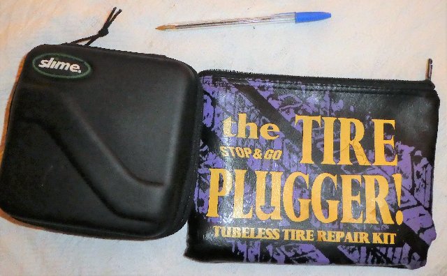

*I used Tire Plugger kit on the road, and at home. No leaks.
and Slime pump.....
I make darn certain that each of these kits is under the seat of whatever scooter I take!

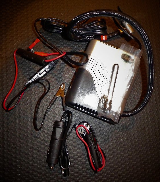

Well, I don't daily ride as much as you but you know the flats I've had from the sticky rope posts here! I think your plugs are more elegant but the sticky rope stuff at Walmart are really cheap and plentiful. The "fixin's" to plug and the hand pump are "met in" permanently just to avoid that tow truck guy! So far, the flats have been all fixed at home base.
The power outlet on the Downtown would not have supported the excellent Slime pump since it originally had a .8 amp fuse. Now, it will since a separate wire and 20 amp fuse was run for the horn upgrade. The power outlet was rewired to that 20 amp line and the skinny wire now goes to the add-on TPMS. Are your outlets fused to power that tire pump?

I followed Karl's idea: I installed a 12 volt socket in the Downtown's underseat basket next to the wimpy light and ran a 12 gauge fused wire (15 amp) directly from the battery. I also did it on both my GV 250's and I now carry a pump and patch kit in all my scoots. I can now pump up my tires anytime, anywhere.

I have two 15a fused SAE connectors run from the battery to 1) underseat and 2) glove box.   I have one of those 12v pumps  , and it came with a variety of connectors including SAE. I have never repaired a scooter tire, but have the tools/materials ready.   I am thinking about putting a hole in the gy6 scoot tire that I am just about to replace, and try out the kit just do be familiar with the process.

This Slime pump has a Battery Tender-type socket   on it. I just plug it into my scooters' installed Battery Tender  leads...one is under the seat, the other is outside the body panel. The pump comes with 2 other methods to get power.
