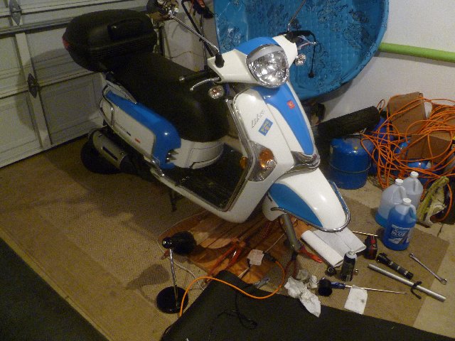

Replacing an 8 yr old tire, which has been on my scooter for 7 yrs.....and still has plenty of tread.
Three things to note, so far:

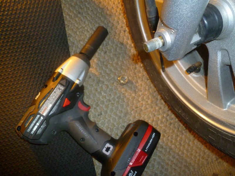

1) That dealer installed 19mm axel nut was a bear to remove! Glad I had an impact gun! White residue on the axel is old Loctite.
I'll wire-brush it off and use blue Loctite again.

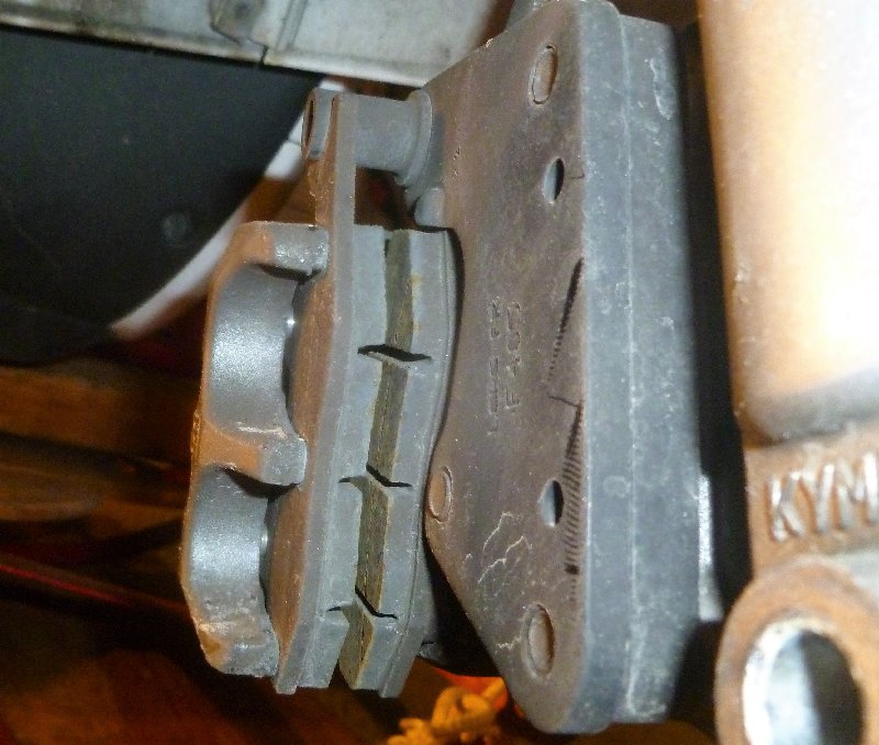

2) 8 year old brake pads look great

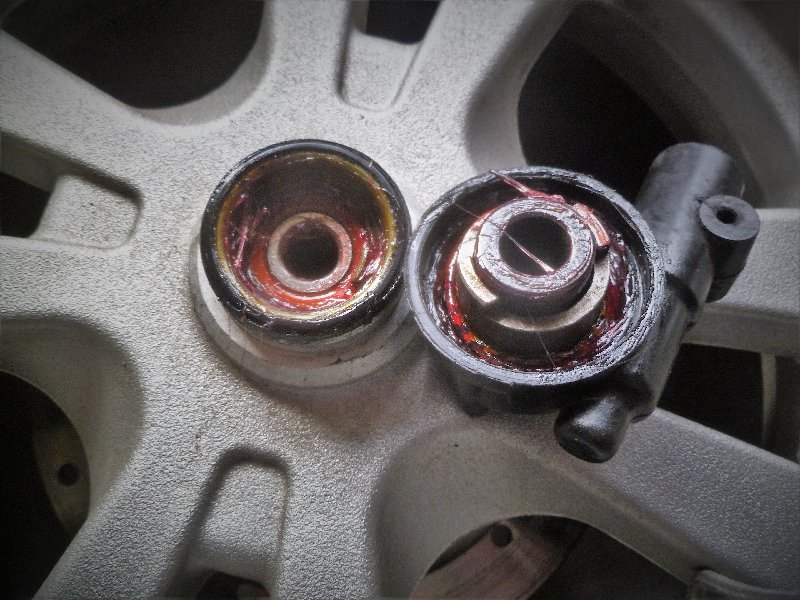

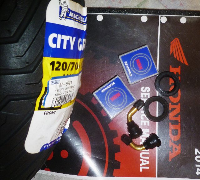

3) both bearings feel smooth, and rubber dust seals look good - may reserve the bearings & only replace the dust seals & valve stem this tire change.

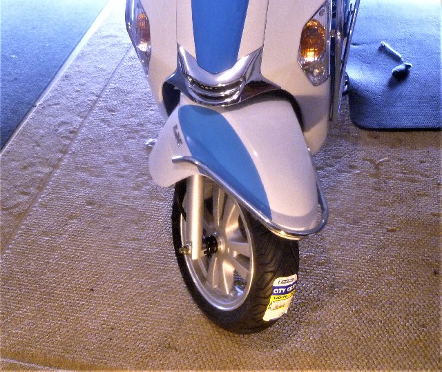

Buttered things up & reinstallation went well, for a Senior.
New tire born -  Feb 2019.

PS: I checked - the speedo still works - I didn't screw it up!
