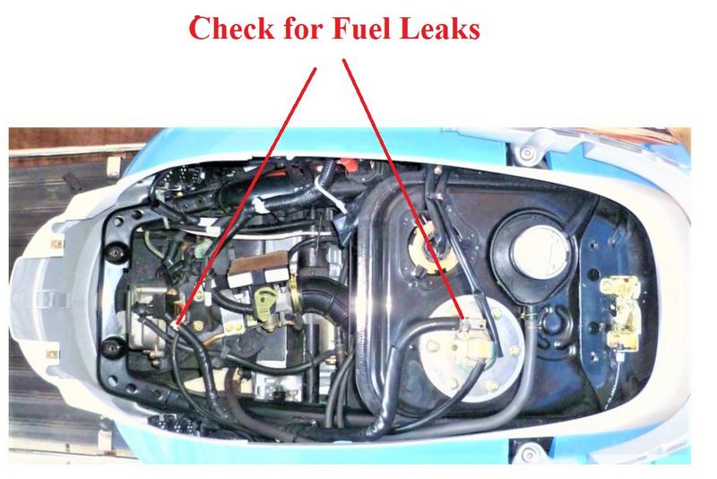

You need to remove the underseat bucket. ...and take a look at things for that fuel smell.
Be careful!
The 2018's had a fuel line leak recall I believe.
Easy to fix....but bucket must come out and you'll probably see it, if leaking, up at tank top or down at the injector.
Take a look. Let us know.
