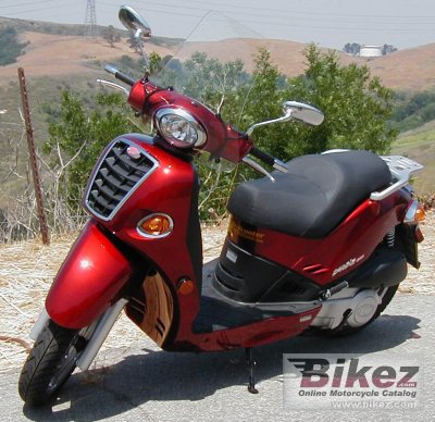

This is People 250:
This is People 250S:
"Your manual" is the same like one I have and it shows People 250, not People 250S.
Try to disassemble plastic parts of 250S using that manual and you will understand what I am talking about.
I already did...

For a number of reasons they just "look" identical but they are not.
S200 is air cooled, S250 is water cooled.
Consequence #1: S250 has much bigger front part of the scoot, inside are both ventilator and radiator grille - S200 does not have either.
Consequence #2: much more plastic parts in front to keep everything in place and different way to disassemble everything too.
