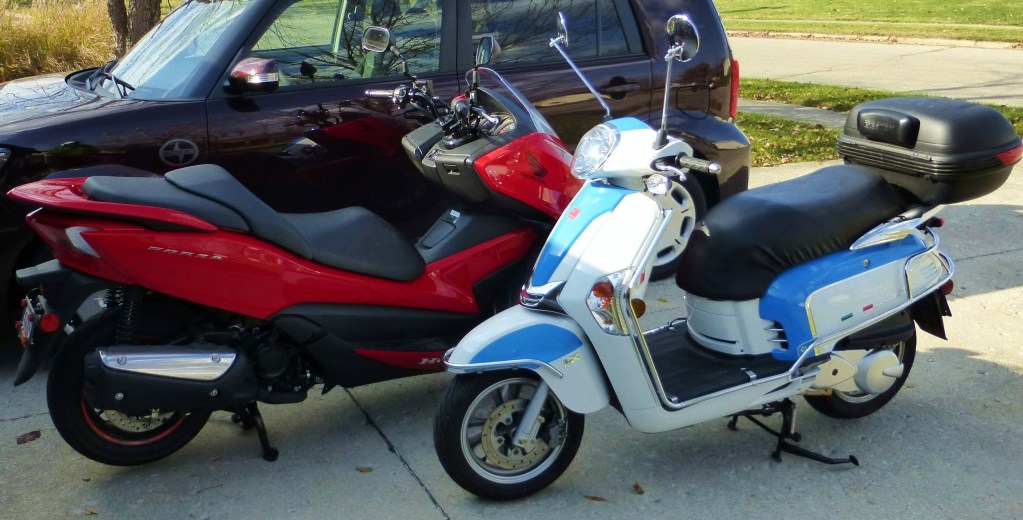

Back in 2014 my year old LIKE200iLX developed a failed TPS (throttle position sensor) and was in & out of the shop for 5 months. Finally I just refused to bring it home until they were able to repeat the problem I was having with it. In the end -  crossbolts and the USA Kymco customer service rep (and possibly my youtube video) persuaded my dealer to replace the Throttle Body - which fixed the issue.
In the mean time - I'd discovered that I loved scooter riding so much - I purchased a nice new Honda Forza NSS300. This is the day they finally met in my driveway, when the LIKE was brought home!
