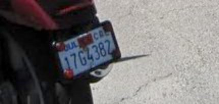

Most motorcycle shops will have them.  Should be about 20 dollars for the Plate Holder but you can get them online for about $5 but watch the shipping.  Measure your plate to be sure you get the correct size.
I made one by taking a 69 cent piece of flashing from home depot, and the $5 frame from Cycle Gear store.  I screwed the metal to the bike, put the frame in front of  the metal and used a marker to mark the edges and for corners.  I used tin snips to round the corners and a drill and made holes in the four corners large enough for the bolts on the plate reflectors I got at Cycle Gear.  I then painted the frame and the metal plate (front and back) with black spray paint.  The then screwed the plate to the bike and then the place the plate n the metal and then the frame, and screwed it all together with the reflectors.
...or you could go the junk yard and get one for a dollar or two.
I could post phots of mine but my bike is at the shop until tomorrow.
ok.. heres a bad photo...

Wow, I never thought about all the cool finds to be had at the junkyard, TechGuy. Gonna keep that thought in the back of my mind. Hey, you got a pretty cool looking one for like 6 bucks there and I like them little plate reflectors. I guess if we gotta have them they might as well look nice. Sorry your bike's in the shop.
