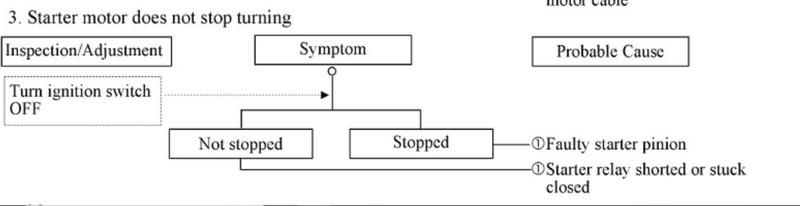

« Reply #2 on: April 25, 2019, 02:02:59 PM »
From cyclepedia....troubleshooting a LIKE200i.

If you switched off the ignition and took the key out, we can rule out the starter button.
Sounds to me like the solenoid/starter relay got stuck. It's a common Kymco issue and thankfully very, very cheap to replace.
I don't know where the starter relay is on your bike though...
