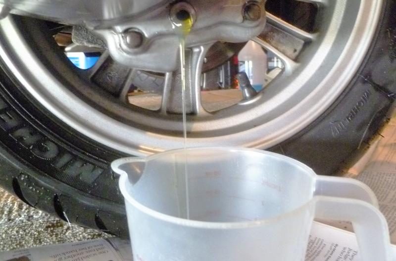

Owner's manual schedule is @2500 miles between changes using 90# oil.
I do them about every 1000 miles.
Today used Valvoline full synth. 75/90W.
Removed a bit under 200ml. Poured the same into the cup, and injected like amount into the ol' LIKE200iLX.

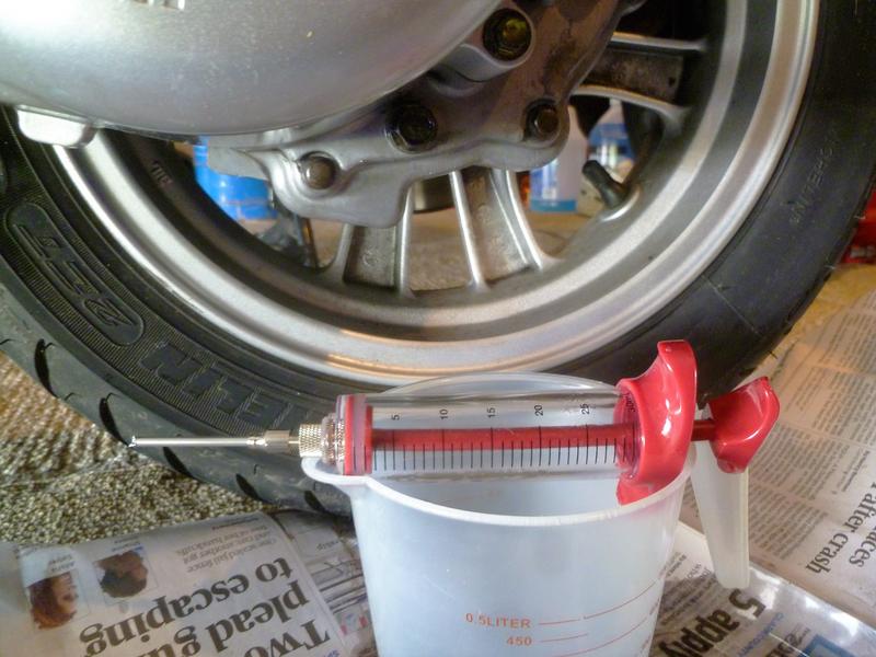

Weapon of choice (works much better than cheap syringes I've tried)
That old felon Martha S. developed this while she was doing hard time. Thanks Marty!

That oil coming from the drain hole (2nd last picture) still looks in very good condition ?
I bought my scooter 2nd hand and have no record of previous service record. I changed engine and gearbox oil just after I bought the scooter.
The engine oil was very dirty, but the gearbox oil was perfectly clean. I couldn't find any traces of moist or metal dust in the gearbox oil, so I thought I will  just change gearbox oil every 5000 km in future.
I assume  these gearboxes come with breather holes somewhere ?
 I couldn’t find a breather hole on my scooter’s gearbox, and my only concern is getting moist mixed with the gearbox oil due to condensation. I think if the oil level is correct at all times,  there should be no sign of metal dust in the oil during oil changes.

The syringe looks to be of high quality Stig. Where can I get one like that?  Oh.. I just noticed.. It's a martha stewart syringe? lolz  Found a knock off...
Also works great if you overfill your engine oil by a bit. Slip the tube off of the bottom of a household finger pump spray bottle. Put it on the syringe needle to reach into the oil via the dipstick hole. Suck out as much as you need.
 I tried two of the cheap plastic syringes sold in auto parts area of malwart - lousy.

Thank you for all your very insightful  & helpful write ups.  I remember also having an automotive syringe that was also terrible.  There is no therapy like scooter therapy. 😄😊🙃
Martha's 'OEM' is on sale too.. https://www.macys.com/shop/product/martha-stewart-collection-marinade-injector-created-for-macys?ID=4768568

If you know anyone in the health care business, a 135ml plastic squeeze enema bottle is one of the handiest gearbox filler tools!
