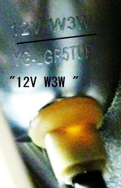

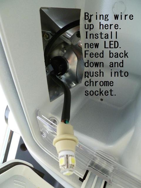

In case you want to mess with the front running lights while we wait for spring.
Pix from a DIY a few yrs ago...…
Buy better LEDs than I used here...I recommend amber lights - so they'll know you're coming at them on two wheels.
But, 5W incandescent bulbs work, too.
de dee

Also, is the W3W LED bulb the LED version of a # 194, miniature wedge base incandescent bulb?  Thanks for your help.

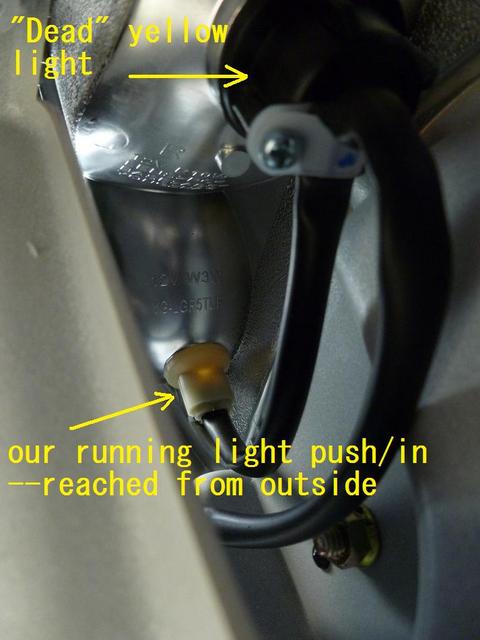

OK, I bet we're talking two different bulb positions on the front of the LIKE.
Coming from motorcycles - I am used to the signal pods. They've never bothered me.
LIKE owners have explored bringing alive the Euro turn-signal positions. I don't recall any DIY for doing so.
I am replacing the bulb in the lower running light position. The socket above, in the amber area, is the non-USA position for the turn indicators.
I'm not messing with that one. To do so would probably involve removing the front of the scooter and messing with the wiring.
I simply replaced the USA 'running light', down here....at the bottom of the fixture.

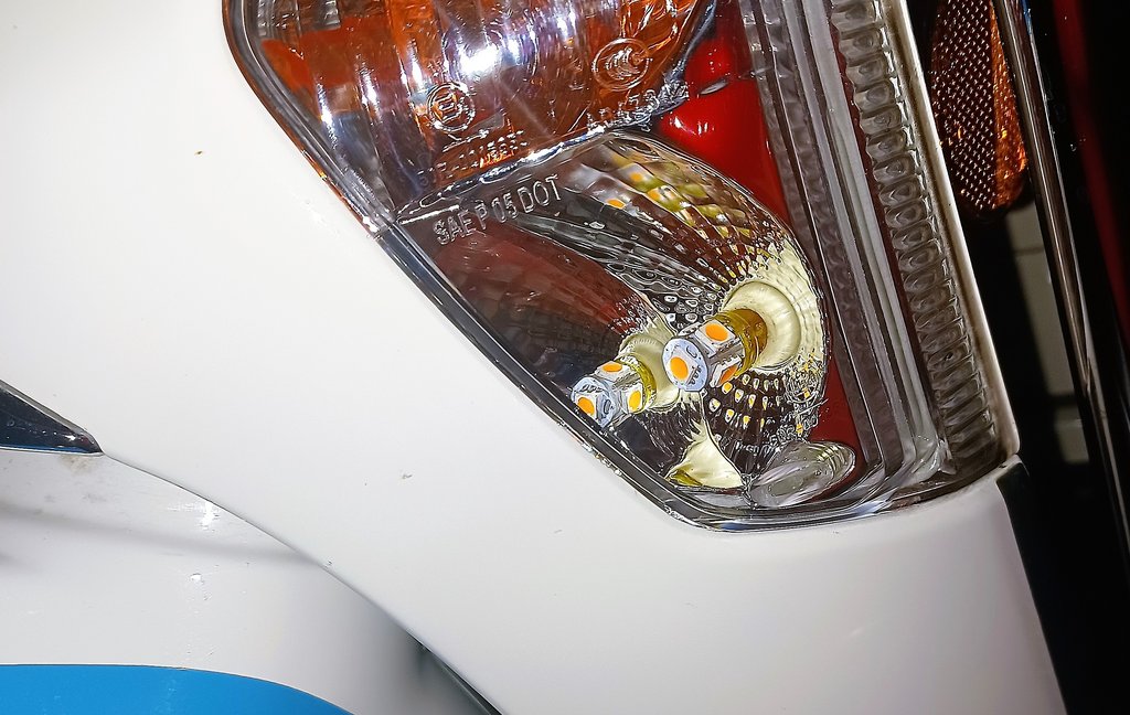

Bear in mind that there's only one LED bulb in there - the one on the left is its reflection.

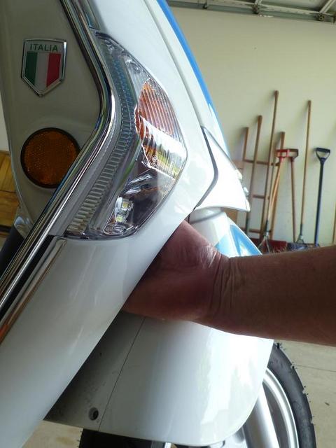

This photo shows how much these amber LED lights project around the front of my scooter.
They make great running lights - but do not operate as a turn signal.

BTW: I mustn't take credit for discovering that these can be replaced by hand , up under the front panel. I saw that somewhere - maybe on youtube - maybe here.
