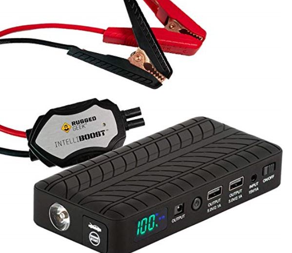

I'm talking about these things....
There are lots of them for sale - anyone recommend one?
I don't want to spend over $100.
A good set of heavy gauge jumpers cables are not cheap - and require you to find a willing donor battery.
Plus I can carry it in my scooter, or the truck.
I'd rather carry one of the little jump boxes. Any serious draw backs to using them?
