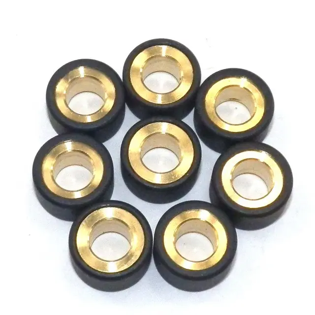

I bought these ..
https://pt.aliexpress.com/item/ROLLER-WEIGHTS-For-250cc-Scooter-Linhai-LH250T-YY250T-14g-20X12mm/32803343491.html?spm=a2g0s.9042311.0.0.515fb90apeEB3l
I'm afraid to use them
4 weigh 14G and 4 weigh 15G
I made the measurement on my wife's precision scale
I think if I decide to use them, I will install interleaved
14-15-14-15-14-15-14-15
What do you think about ????

All must be the same!

A pretty important part of any scooter's performance and reliability. I would hesitate to put $9 knock-off parts in my 300cc scooter.

They are not, I already told
you can make them all the same Wt.  get a larger drill then the hole and just touch it to the brass metal and weigh it to see how much came off,  1 gram is very small
Re: Got my rollers but?
« Reply #12 on: November 20, 2018, 02:34:30 AM »
De dee, genius! But practical as well. It occured to me this is how they got that 14.5 gram weight! 4 at 14 grams and 4 at 15 grams, each weight placed opposite and staggered. Fulfills the spec weight but I doubt it was dynamically the same!
Not nessasarily.... I also have different weight rollers on my 350DT..4 weigh 14 gr and 4 weigh 16g.You get the best of both worlds. Lower and higher RPM speeds.
