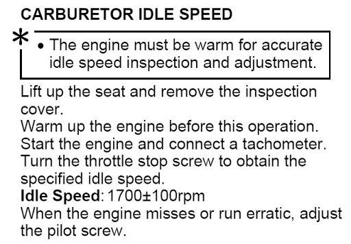

So far in this discussion no one has mentioned that idle speed affects charging.  I found my Xciting seemed to be having charging problems when I first got it.  I noticed the idle speed was 500 rpm below manual specification.  I increased it and problems went away in short order.
I carried a phillips screwdriver around with me for several weeks to fine tune it.  Make sure engine is completely warmed up before adjusting the idle speed.  And it will vary a small amount depending on the weather and temperature.
Usually, when idle is below rpms where it should be, it can be noticed, especially during cold and damp morning drives, by engine shutdown when you stop at the sign or turn somewhere. So, most people tend to increase idle before it can be manifested as inadequate battery charging. You are among rare patient ones. :) :) :)

Right axy.  Actually I was also having occasional stall out problems too, during first few weeks I owned the scooter.  Increasing idle cured both.  ;)
Now the battery is good and strong each and every start.
I had taken it to a local battery shop where they load tested the battery, telling me it was ok but wasn't receiving charge at idle speed.  That's when I went and read up what the idle speed should be.

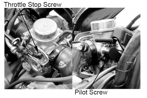

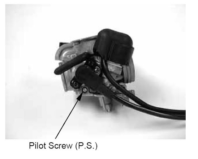

Is it possible that this discussion about the idle speed mean you are adjusting two different things?  One is the Throttle Stop Screw and the other is the Pilot Screw.
The Throttle Stop only effects the idle speed in that it changes the minimum position for the throttle cable.
The Pilot screw adjusts the air/fuel mixture (of the bike at idle rpms ... as set by the Throttle Stop Screw)

The "throttle stop screw" is the idle speed adjustment, as it is on all carburetor-equipped engines.
The "pilot screw" is, as you say, the fuel-air mixture adjustment, which unless you change altitudes often (and radically, at that) will likely never need adjusting post-PDI.
