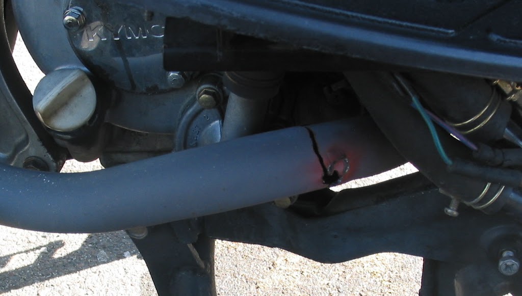

The pipe cracked behind the heat shield's mounting stud.  The crack runs all the way around the pipe.

Finally goy my muffler/exhaust assembly.  There is a some shipping damage and now... the top hanger bolt snapped in half... wheeeee  ??? :-\

Try a left hand twist drill bit to remove the broken remains of the bolt. It may catch as it is drilling, and simply spin the piece out. Have you thought about having a sleeve welded over the crack? Just to get you by untill you get the replacement... Sometimes if it weren't for bad luck...

...sleeve would work...heck, i cut my whole muffler open and welded it back...lol..

Let's put it this way... when I took the two remaining bolts of the muffler proper... the muffler hit the ground and the heard piece was still attached to the engine.
 The  old muffler sounds like there is a rock inside of it.  ... think... thiunk
