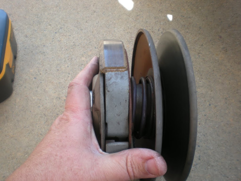

OK, My Kymco P250 had stalling problems last month when pulling away from an intersection.  I replaced the spark plug with an Iridium plug and I replaced the spark plug cable.  While I had the tupper off I also added sliders, cleaned the clutch pads (scuffed with a green scrubby), cleaned the old clutch pad dust out of the clutch bell and checked all the bits there.
Now, when I roll up to a stop sign or light, the engine seems to bog until the clutch shoes release for a true idle.  If I stop and the clutch shoes drag, the engine wants to stall.

The idle seems fine or slightly low.  It's not racing or anything like that. I was wondering if the new sliders stay out longer and transmit more to the belt/clutch which keeps the bike "in gear" longer when rolling towards a stop. The clutch pads look fine.

I have not experienced any prolonged engagement with the sliders, nor have I heard of them causing that.  The clutch looks of from the outside.  Can you see the fly springs in the back?  Maybe try pulling on the pads and make sure there is not play.  You may have to take the clutch off of the torque driver to inspect the backside where the springs go.  The pivots the pads move on my be sticky and not fully returning.  You could take the fly springs off and move the pads on the pivots, make sure they aren't binding.

..it may just be the camera angle, but do those pads look like they are wearing unevenly?

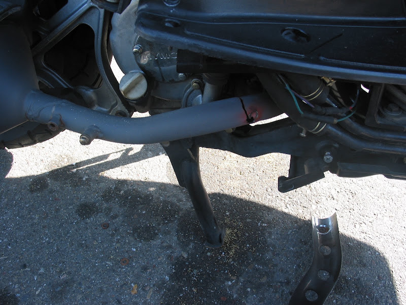

Re: Stall when stopping -> Leo Vince or New Factory Muffler? Why?
« Reply #13 on: March 29, 2010, 07:00:44 PM »
Do you think this might have been a small factor in my inability to idle?  :-\
My NEW QUESTION:  Leo Vince or Factory Replacement Muffler?  ... and why?  Just looking for confirmation of my suspicions/feelings.

« Reply #14 on: March 29, 2010, 07:16:29 PM »
..A LV muffler will require carburetor tuning after installation, but should ultimately increase performance..factory replacement should be plug-n-play...
..your pic didnt make it thru...
