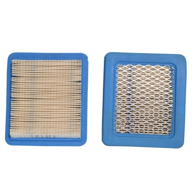

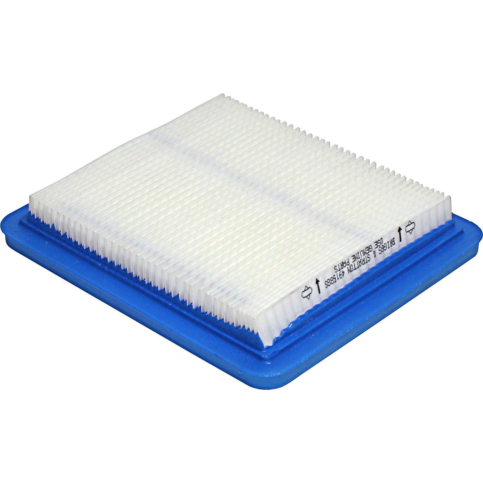

So I came across these filters at Sears for $9.99. They are 4.5" W x .75" H x 5.25" L, so just a little thinner than our OEM Kymco filters which are 1.25" as opposed to the 0.75". I thought that it would be be nice to pass this along in case someone does not want to pay the $45-$50 for the OEM/Dealer part. You could add a piece of weather stripping to create the tabs that the OEM filter has or use a couple of globs of RTV Gasket Sealer to make up for those tabs not being there. Perhaps there is an actual hi flow filter that is a direct replacement for this filter and we no longer would need to modify the OEM/Dealer filters.

If you purchase one of these filters and add RTV Silicone Gasket Maker make sure it is
Oxygen Sensor-Safe
Because Kymco's xciting 500ri has a Oxygen Sensor plain old Silicone sealer flumes being sucked in through the air intake will ruin your O2 sensor. Permatex is one manufacturer who makes Oxygen Sensor-Safe gasket maker.
Permatex® Ultra Black® Maximum Oil Resistance RTV Silicone Gasket Maker
OEM specified. For dealership warranty requirements, Ultra Black® ensures extended drivetrain warranty compliance. Fast-curing formula.
Sensor-safe
, low odor, noncorrosive. Meets performance specs of OE silicone gaskets. Retains high flexibility, oil resistant properties through use of a patented adhesion system. Temperature range -65°F to 500°F (-54°C to 260°C) intermittent; resists auto and shop fluids and vibration.
- See more at:
http://www.permatex.com/products-2/product-categories/gasketing/gasket-makers/permatex-ultra-black-maximum-oil-resistance-rtv-silicone-gasket-maker-detail#sthash.WmI9ntoH.dpuf

Great information to know! Thanks for adding that Doc!
