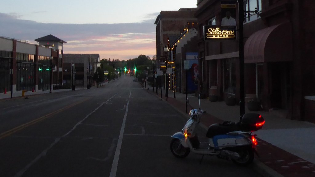

I'm lousy at most electrical things and the tail lights on a LIKE are a puzzle box to me....and this top box comes with no instructions.
OK, first off -- my apologies to KYMCO - they did not design a stupidly complicated tail light assembly as I fist thought.
2 bolts and 2 screws and 2 pop plugs and I was laying on my back staring happily at a bunch of wires and bulb holders!
Using the wiring diagram  in the cyclepedia LIKE manual and some parts from the old stock top case....in a zillion short hours I had some lights that almost worked correctly. I went to Easter Evening church and came home and tried again - and -(yes) Bob's-Your-Uncle !    I had all the lights working as advertised!
(I had cut the scoot's running light wire by mistake - trust me - I am not that good at sorting out electrical probs - plus it was a very good sermon)
I am one of those scooter riders who worry almost more about what's coming at me from behind - than in front.
The LIKE has a BIG tail light (one of the things I liked about it when I was shopping scoots) - but I wanted more light back there. This Bestem is too big for me - but it has the lights I wanted.
 VERY bright LEDs in this thing - the ring of running lights is bright - and the top brake light AND that ring of lights gets even brighter w/the brakes!
 here is the wiring code for putting this on a LIKE 200i.
BOX wires                                                                             SCOOTER  wires
Blue & Black to                        to                             Green /Ground
Red & Brown                           to                             Green w/Yellow stripe for Brake Light
Green                                      to                             Brown for running tail light
This combination will add (to the stock lights) a ring of LED running lights whenever the scooter key is on, and,
when you pull the brake levers a top/center brake light comes on - plus the ring of lights gets brighter, too! (= a LOT of brake lighting!)
I'll feel some better going to work in the dark every day, and commuting in the rain,  with this lighting, and If I could do this.....a chimp can do it.
Worked fine for me at 5000 miles and 13 months.
wires routed from tail light assembly through body to the case

I have 2 issues with this case on my LIKE : it is too big - (but was the only one I could find for the $$ with lights) , and I do not like the idea that it is being held to my scooter by 2 pegs on the front of the metal base slotting into plastic slots on the bottom of the case, while the rear is plastic snugged down to the base by a quick release plastic handle. I can imagine no instance where I would want to take this off and walk around with it. And I do not like the slight movement I feel between the case and the metal base. I think I'm going to use the 4 bolts used on the Kymco case and some fender washers and bolt this X 4 through the base plate and into the 4 holes on the LIKE's rear rack.
I do not want this case to bounce off on rough roads.
