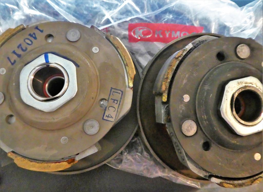

#1) 2014 - TPR failed, throttle body replaced under warranty.
#2) @2018 - little spring in the clutch let go - leaving the clutch slightly engaged at idle.
