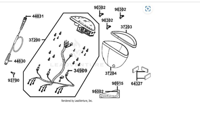

This might be the same speedo as yours, taken from a parts image....there's your bulbs.

Thanks for the information Stig.   I’ve looked at that and some YouTube videos and it appears that the dash illumination strip is powered by an inverter located on the circuit board on the back of the dash itself. Supposedly this is a common issue with the GVs.  The video shows the fix after you get to that circuit panel but doesn’t show the steps to get to that stage.  I’m just looking to see if anyone has actually had some experience doing the whole process.
