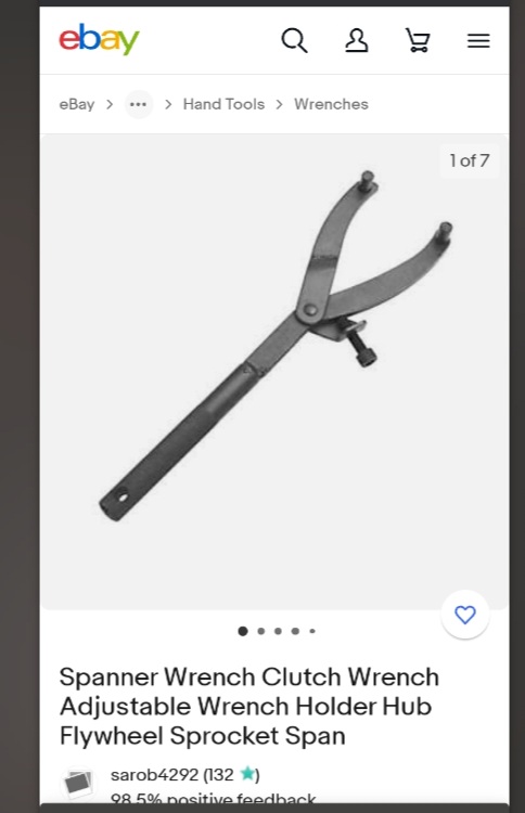

Ebay for about $12>$19
Used it on all 4 of my scooters. 155>400 cc's
Thanks Stig, that looks a winner!

Made my own clutch/variator holding tool from two pieces of flat bar about 24" long, about .75" by .25", each with a .25" at each end. One end is the pivot, the other ends get a M6 x 25 or 30mm bolt  and nut.
With nuts in place, the heads go in the clutch holes, without nuts, in the variator holes. The pivot joint goes on the floor.

Thanks for the pointer Stig, ordered.
