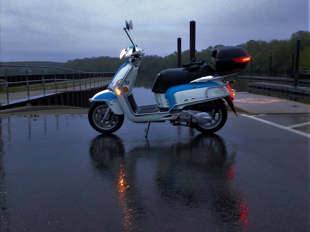

final pic in this series..went for a 24 mile ride late this morning..everything is working fine, nothing shook loose or fell off, so that's good! I will correct an earlier statement where I said the scoot's sweet spot was 25-40 mph. I think it's really about 20-35 mph where it feels best. I completely understand Stig's target early morning riding speeds.

I hope nothing!...but we all know that isn't going to happen...I do have a master brake cylinder rebuild kit and caliper rebuild kit for the Helix...sitting in a box...hmmmmm.....

After what you've done Hawk, those two repairs should be a cinch.  Although the c-clip in the master cylinder can be a bitch to remove/replace.  As for the sweet spot, does it seem low?  My Cali 200 (169cc) glides effortlessly at 35-45mph (actual).

I guess I'm referring to the 'comfort' sweet spot speed (?) Very comfortable at those speeds. The faster I go (it will hit an indicated low to mid 60's in perfect conditions - downhill) the rougher the ride gets. A stiff, cheap suspension with not a lot travel doesn't = a nice ride at higher speeds on anything less than perfect pavement.
I rode my Helix last night..and with the foot longer wheelbase and softer suspension it's a joy to ride at highway speeds. None of the jackhammer-like feeling in the bars at speed.
I still love the S200..but it's my 'around town' scoot and will choose my other rides for higher speeds.

I’ve put about 140 miles on the scoot since the motor ‘reassembly’ and there are no oil leaks. I’m actually kind of pleasantly surprised because I would have bet that something would be seeping / leaking / dripping! I also didn’t have any left over parts form the rebuild…that’s another pleasant surprise.
