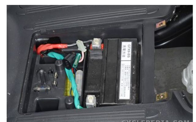

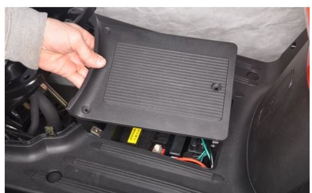

Servicing a LIKE200i is easy: 3 screws on the battery cover, located beneath your feet!
