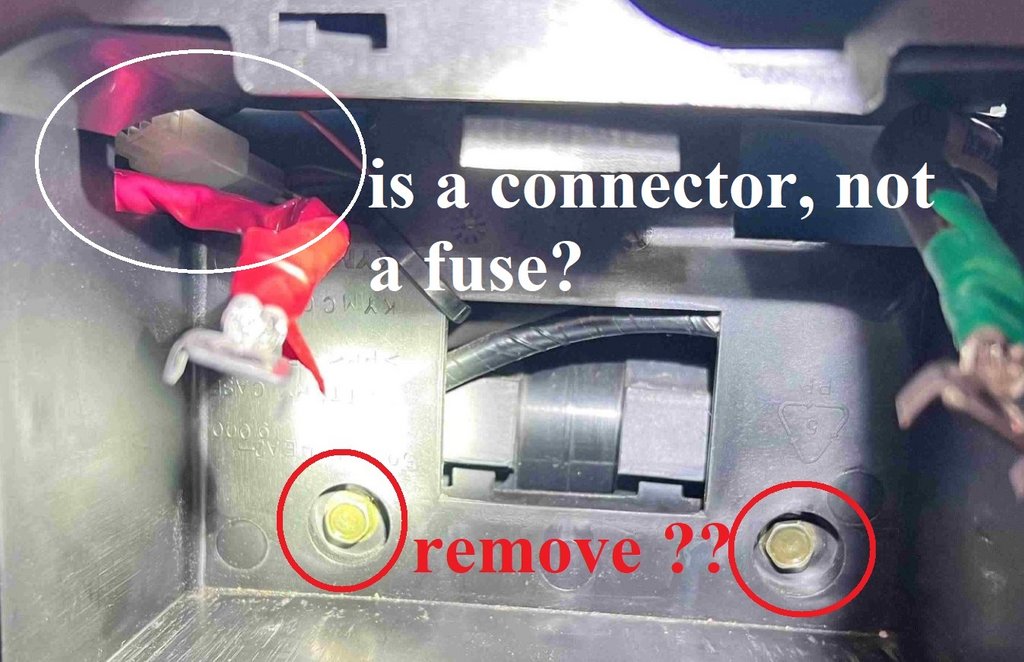

I’m pretty sure a fuse is blown on my scooter. I’ve located the fuse but cannot access it. It’s behind the battery but wedged behind a compartment that I can figure out how to move. It seems I’d have to take apart half the bike to get access to it. There’s not a lot of give if I pull the fuse box. There’s no way I could replace it without further access. Scooter is 2013 Kymco Compagno 110i.
SOLVED
Thank you everyone. The fuse is to the left of the battery when facing the battery. I unscrewed two bolts holding the battery compartment in. This allowed me to unclip the fuse box and replace the 15A fuse.

I'm not clear as to what part you are trying to get to from your pictures...can you put an arrow in the picture pointing to what you need to remove? If you need to pull the battery box it looks like 2 (likely 10 mm) bolts need to be removed from the bottom.
I find online parts schematics very helpful in determining how the various parts are attached. Not sure if the Campagno was sold in the US as I'm not finding any online parts listings..

Have you tried removing the two bolts (RED) ?
Are you thinking the white thing top/left is a fuse?
Wonder if it might be a wiring connector - might not be a fuse. In other words the fuses may not be back here.
No help from the owner's manual I take it?
We may not have had that scooter sold here in the States - so our help is going to be spotty - unless fellow owner steps forward?
Was able to get those bolts off, you are right, that is a connector not a fuse. I found a blown fuse to the left of the battery (15 A) that I replaced. I have a red 10 A spare fuse as well, not sure where this would go, any ideas?
