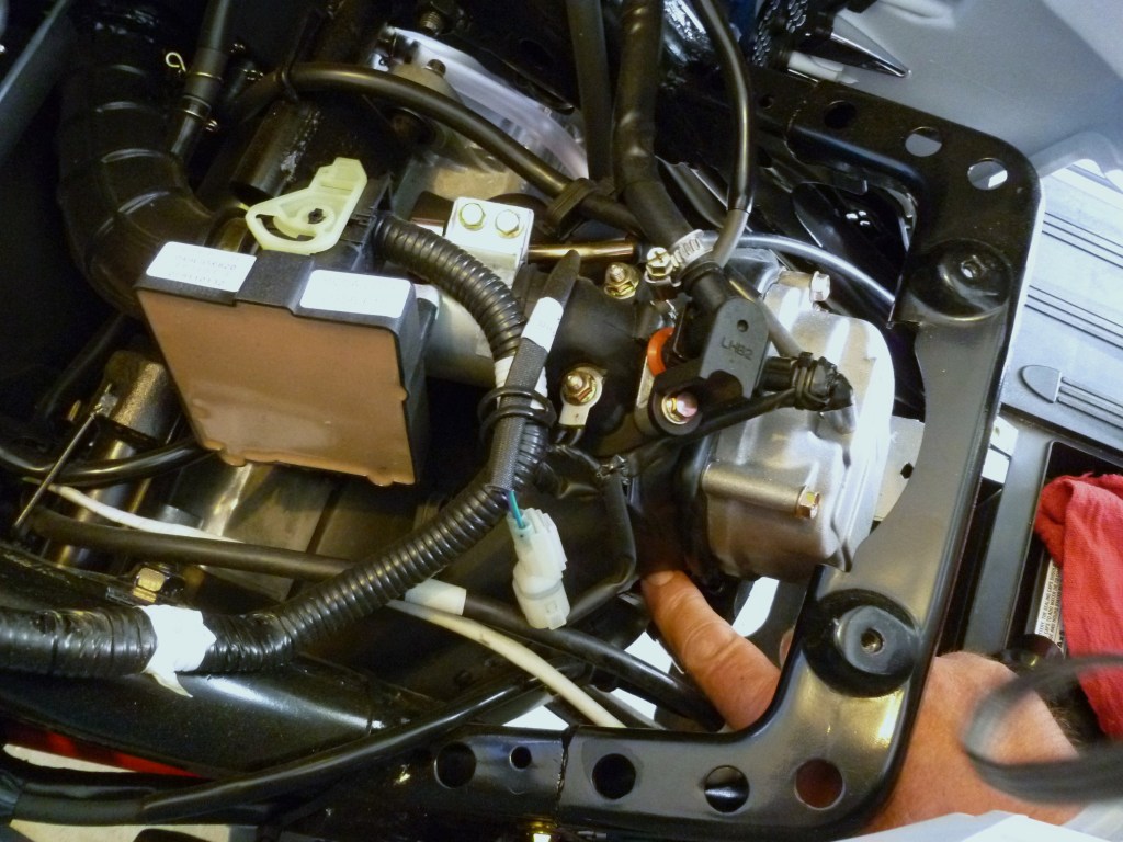

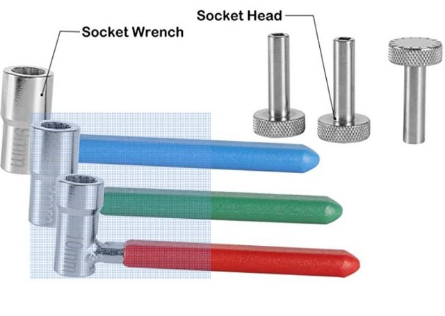

Gathering new gaskets and NGK's, and just purchased a new tool to make things easier.

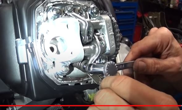

Robot using the tool on same Piaggio 155cc engine.
I will be doing a valve adjustment on both scooters in a few days. And while I'm in there will replace the 2 gaskets on the Liberty and one on the LIKE....and spin a new Iridium NGK into both.
The LIKE is somewhat easier because of all the room my hands have, and the panels are few & easy to remove. But the Liberty is only a little tighter. The 1st time it took an hour to wrestle a hose clip off in tight quarters on the Liberty's engine!
there's always something....that first time, isn't there!
I remove the seat and under-bucket as a unit on both for better lighting and ergo's etc.
I do the valves yearly - regardless of mileage. It's probably more of a bonding thing -  :)

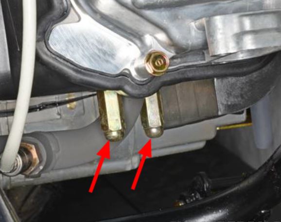

while I'm at it, will replace these exhaust nuts as well. ACF-50 inspection noted I could use a pair of fresh ones before next tire change

Nice tools! Great idea!
I gotta do some of that, too....
