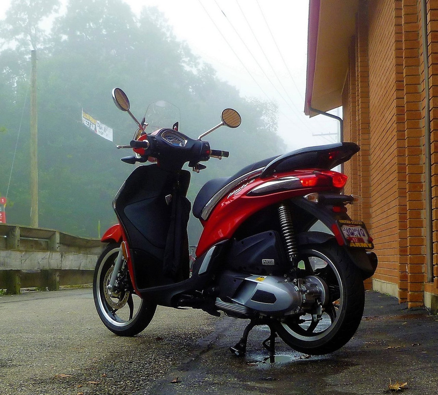

Just don't understand the difficulty with photos. Placed this here with my phone.
