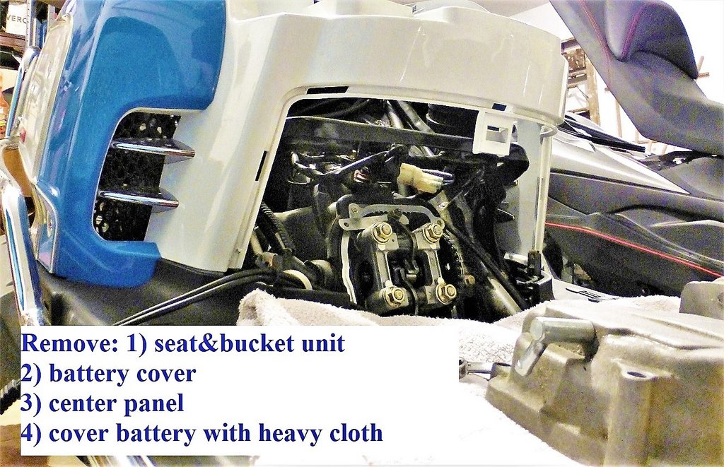

Thanks Stig, I now see some of the allure of your Like.
To do the valves on it's cousin the S200 you have to remove most of the body work.
Not as bad as you'd think, really about 20 minutes extra on the job once you know what you're doing, but still a bit of extra fiddling an access panel could fix.
2008 SYM HD200 "Niwanibiz"
k9 S200 (Blue) "Max" (Sold)

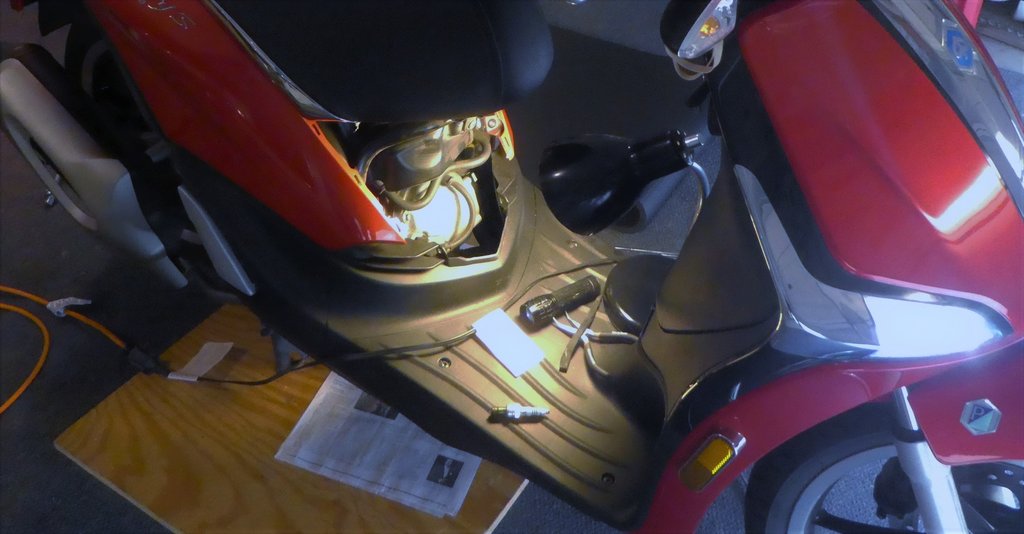

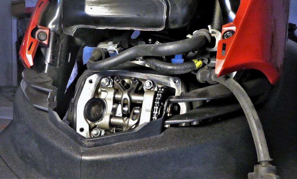

The LIKE - yeah, you can actually do it with the seat in place - but I like the extra daylight down there so I take it off.
Just need to undo the 3 screws on the battery cover and 2 screws on the center panel and pop it off carefully. Put a heavy cloth on the battery and go to work!

Sometimes one is a little tight. Well, too tight for my liking.......
"Problems?" : once I tried to set fire to my LIKE by forgetting a paper towel placed to catch oil drips when removing valve cover. A few miles later I smelled something trying to catch fire.
And, on the Liberty - the valve cover gasket slipped out of place when I put the cover back on - and started a small oil leak.
I keep spares of the gasket for both scoots.
One of my hobbies is reading all the excuses that Honda PCx owners give for not ever checking their valves.....a job which requires starting back at the tail light and working forward! :)
