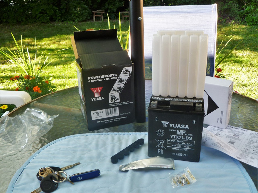

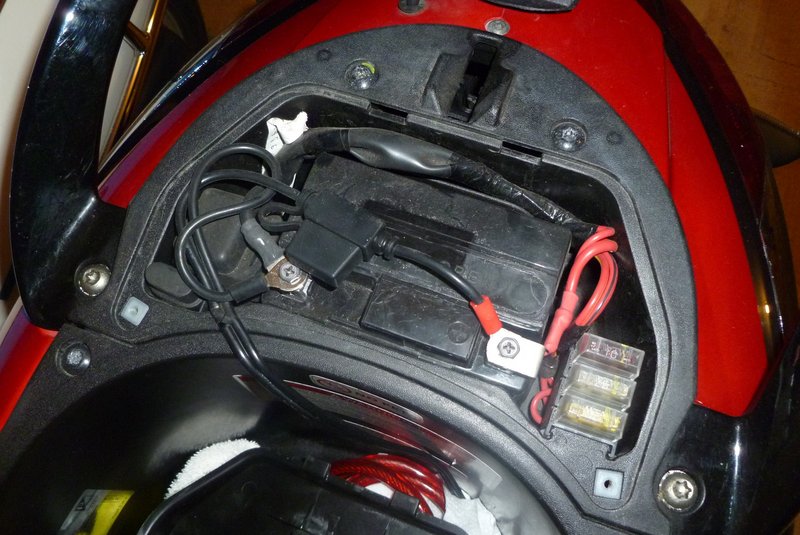

This is the 5th (hot!) summer riding with my Liberty150i's little 6Ah battery.
(this is the first scooter that I couldn't stuff a bigger battery in! - for my winter riding)
Above is good little video I've found - put out by YUASA for working with a new battery.
I'm using a Deltran Battery Tender Junior to charge and maintain my new battery this afternoon.

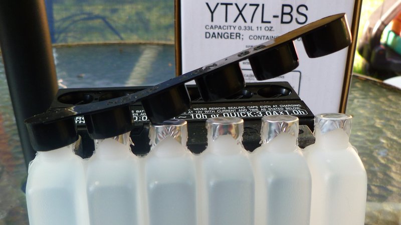

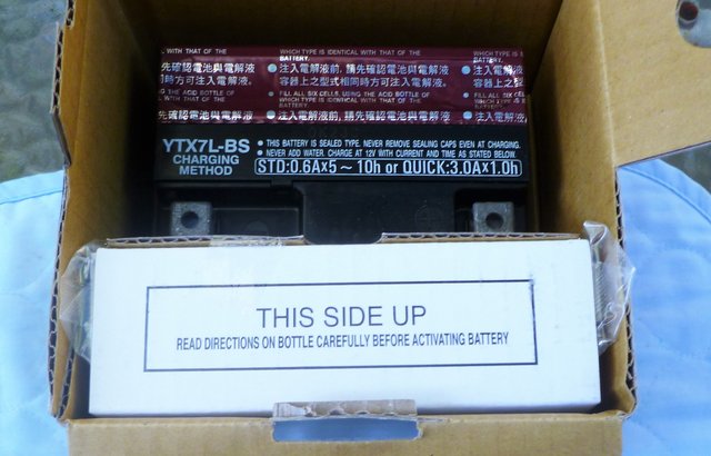

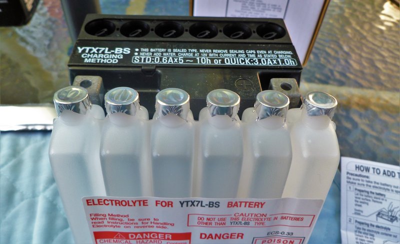

For the first time, because it's a little 6Ah battery - I chose to go with an "add the acid " Yuasa battery.
Tips:
The neg connection comes off first - goes back on last.
Some say add dielectric grease to the new posts.
Let it stand after adding acid & before loosely replacing caps during charging.
Need two thumbs to secure the caps after fully charged.
Snug in there!
