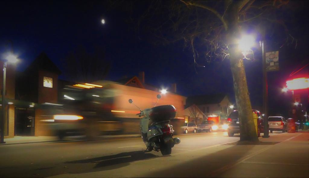

I went with 1gm lighter Dr P sliders in my 163cc LIKE...
Great photo with the truck in the background.
