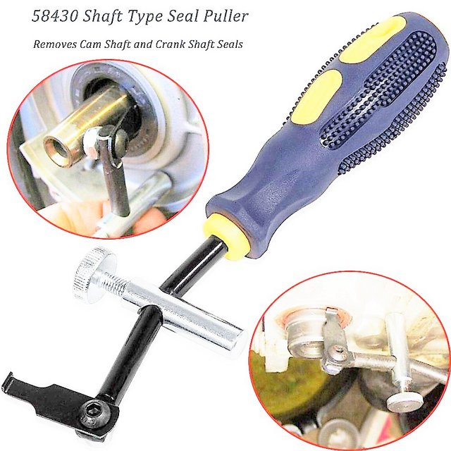

As for seal pulling....I like this little tool.
Re: The LIKEs multiply...
« Reply #8 on: April 17, 2021, 07:21:51 PM »
@Stig, thanks for this tool,
now I remember having seen something similar years ago, forgot completely. Have to order.
