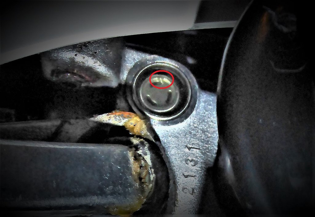

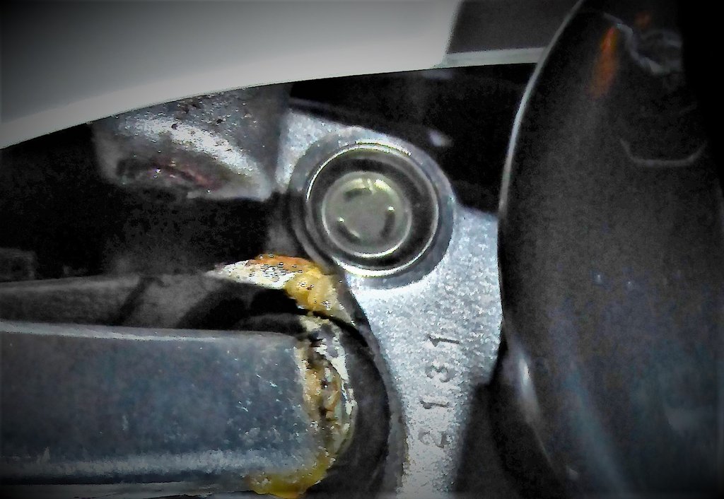

« Reply #9 on: December 27, 2020, 04:26:34 PM »
Sometimes you won't see much more than a small bubble.
If the fluid is not darker - it is considered to be OK.
Amber to light amber is good.
Your photo shows that your color and fluid level is good.
(These are photos of my LIKE200i - not the LIKE 150i)
BRAKE FLUID DIY ON A LIKE200I
