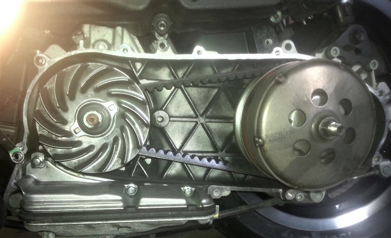

A fellow owner of a Piaggio Liberty150i just completed a rear wheel removal, and removed his the belt cover for the first time.
I mentioned that I'll soon be doing these same procedures on my Liberty. (belt is due in @ 500 miles, tire replacement is close)
He very kindly texted me several photos of his work with a few work-arounds of trouble spots which he encountered ("stuck" belt cover, of course).
Pretty cool to have a real life look at things, as the Piaggio manual download is very casual about anything other than a complete engine teardown!

Very interesting. The cooling fins on my Agility’s Variator pulley are curved the opposite way. The air inlet opening at the variator Housing is located at the front of the housing more or less in line with the cooling fins at the pulley. The outer curves of the cooling fins are pointing at the air inlet opening at the housing - which means air will be sucked into th housing by means of the cooling fins, forced towards the center part of the fins, and the outwards away from the pulley when the engine is running.
Which makes me wonder - if the cooling fins are curved the opposite way like on this Piaggio, surely the air inlet opening at the variator Housing must be located at a different position ?
A photo of the fins on my Agility's variator can be seen below.

I believe the fins pick up the air just about at the 7 O'clock (maybe 6:40; quarter till 19:00; 6:50ish --- depends on dinner time in Naples)
