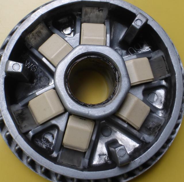

Nice and brisk in the garage these winter days - good time to do a cold engine valve check - and have ordered a new set of Dr Pulley sliders and slide pieces for that service day.
I use 18x14x14g weights. I found that the 13g weights raise my cruising RPM's too much over stock for my liking. I never run my LIKE200i WOT and never seek max speed, or test for MPG's - so other than the cruising RPM's, I've no idea about performance between the two weights. The sliders just give me years of smooth performance. (never a problem with them flipping - which is due to an installation error IMHO)
https://www.buggypartsnw.com/index.php/dr-pulley-products/dr-pulley-slider-weights/150cc-250cc/dr-pulley-slider-weight-18x14-for-125-150cc-gy6.html
I have no plans to use Dr P's in my 155cc Piaggio - I like everything about its stock over-the-road performance just fine.
