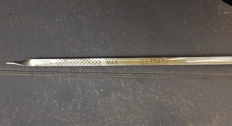

Had my Silverado oil changed at local Chevy dealer a few days ago.
While under the hood replacing the airfilter yesterday I noticed that my dipstick was showing an oil level as seen in the photo.
An email reply from the serv. dept. gave me the proper instructions for checking the oil level,
"WHEN VEHICLE HAS SAT FOR 2 HOURS YOU HAVE TO START THE ENGINE  AND LET RUN
FOR 10-15 SECONDS, THEN TURN OFF AND WAIT 5-10 SECONDS. REMOVE DIP STICK,
THEN REINSERT AND PULL AND READ OIL LEVEL. THIS IS THE PROPER PROCEDURE.
WHEN VEHICLE SITS FOR 2 HOURS OIL DRAINS FROM THE TOP OF THE ENGINE TO THE
OIL PAN CAUSING AN OVERFULL READING. Thanks Tim M."
Service bill shows they put in 6 Qts of oil into my 4.5 Qt. engine!
(my fault for not checking the print-out)
This is what 6 Qts  looks like in a 4.5 Qt oil pan.
Pd $51 for this official Chevy Serv. Dept. oil change.
Headed back for a chat with Tim.

That’s unfortunate.  Although they should know better, the 4.3 (I assume that’s what it is) is the only engine choice that takes 4.5 quarts. I believe the rest of the engines use close to 6 qts. Also, I’ve seen one person pump the oil that was set for another tech. So someone else may have only 4.5 qts in a 6 qts pan . Yes, they should have checked to verify the level after they finished.
That’s why I and most other mechanics HATE doing oil changes. It’s the ONE thing that has the smallest reward (pays 3/10) , usually has to be done in rush ( because of the oil change places offering 10 minute oil changes , and the biggest potential for disaster if a mistake is made (could result in a ruined engine).

I've much less of a problem with the kid using too much oil (thanks for pointing out that most do use 6Qts) - but the email explanation from the serv. writer just seemed too bizarre. I checked his instructions with two other Chevy dealer serv. depts. and could find no support for it.
I learned that this old fellow was a new employee (from the dealer operator - who'd never heard of him -"must be new" )
He went very quiet when I handed him the serv. receipt which listed that 6 Qts of oil had been put in my 4.3Lt engine.
His email explanation for the proper way to check the oil showed so much imagination and flare - that I've voted him through to the final round of "Mechanic's Song & Dance" in Atlantic City.
It’s really not as stupid as it appears. He was probably following some form letter instructions from GM. I’ve gotten worse from the Ford HOTLINE. They usually read a script until at least the SECOND response. I don’t think they even pay attention the first read.
By the way, the Ford 2.7 BEGS to be overfilled. If you don’t wait 15 MINUTES it will likely read LOW. I brought one in for a pre delivery inspection. I checked the oil about 2 minutes after i shut it off. It wasn’t touching the dipstick! Sure enough 15 minutes later it read full. I found that it has some pinhole sized opening to a mini reservoir. I had to inform the oil change guys because they thought the dispenser was short changing them.
