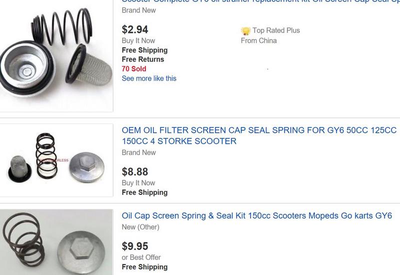

Are you talking about these things?
Plentiful on ebay.
Have a spare kit for my LIKE200i.

Whatever you do, rather don’t get one of the cheap replicas from China. I ordered a cheap plug from China and it fits - but the threaded part of the plug is shorter than the threaded part of the original plug. Which means changes are better that the thread on the plug or sump could be damaged when the plug gets tightened.
