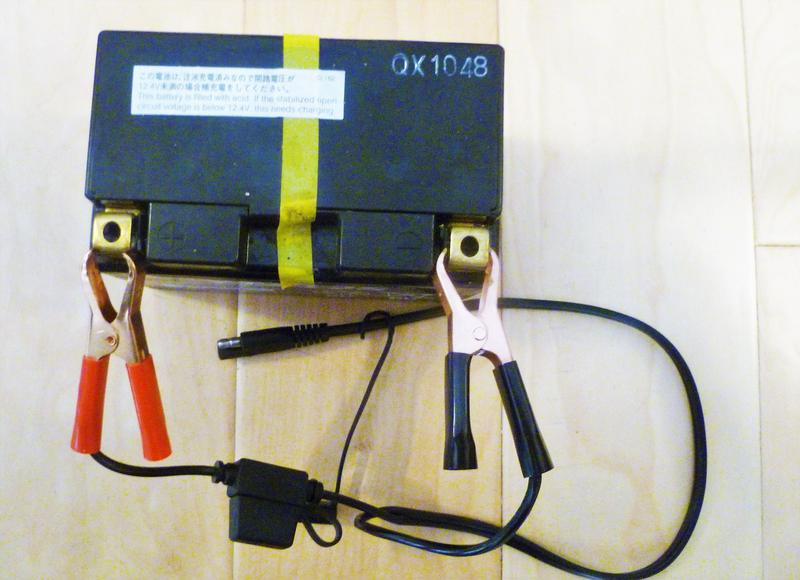

I am getting ready to start my season of State Park rides in the teens and 20's (F).
I often stop for photos, goofing, scratching, deer, coffee (< and having a wee) - and do several re-starts.
I have 3 spare/good YUASA batteries taken from scooters which I keep charged.
I'm thinking I will toss one of those spare batteries (and the jumper cord seen in the photo) under my seat - "just in case" I get a no start from my scooter's battery.* I would attach the spare battery tender pig tail to the scooter's battery tender pig tail..
This should work, right? Or, no?
* In case I don't remember to shut off my floor and seat heater, the Blue-Ray player or the LORAN?

This got me thinking about something that has been in the back of my mind.  Neither my Yamaha Morphous (250cc fuel injected) nor my Bet & Win 250 (carbed) have kick starters.   If the battery goes weak when out on ride, could leave me stranded.
Electrical stuff is out of my area of expertise, so I would like some input on this idea.   Both scoots have easily accessed connectors for Battery Tenders.  I was thinking of carrying an extension SAE cable with alligator clips on one end to use as jumper cables in a breakdown situation.
Connected to a car battery or another bike should provide the power to jump start.  Assume the car is not running when jumping, would the much higher amperage on a car battery damage the battery or wiring on the jumped scooter?

DanV: no. It has a higher ampere CAPABILITY than the installed bike battery but makes the same voltage. The only downside is connecting the two incorrectly! Don't do that!

I have jumped scooters and motorcycles from car batteries before with no issues.  I normally just jump from the battery without having the car running.
