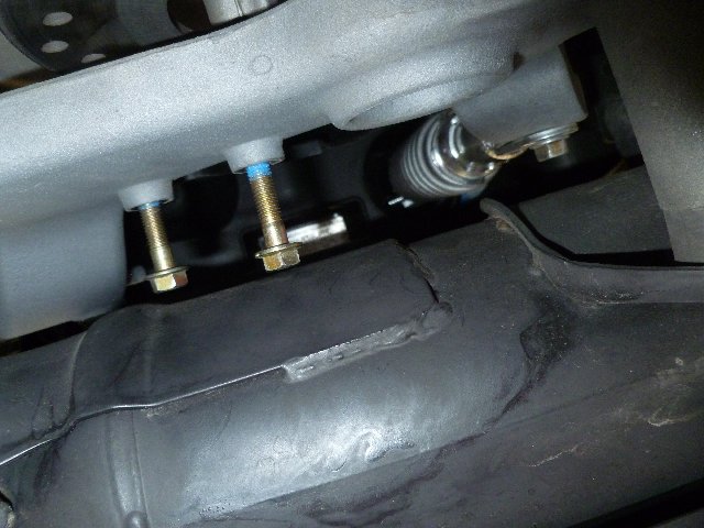

Just a note. if you are doing a rear brake pad replacement on a LIKE200i , it is not necessary to remove the muffler. There IS room behind the muffler to loosen the caliper mounting bolts enough to remove the caliper. Apply some blue thread-lock when tightening.
