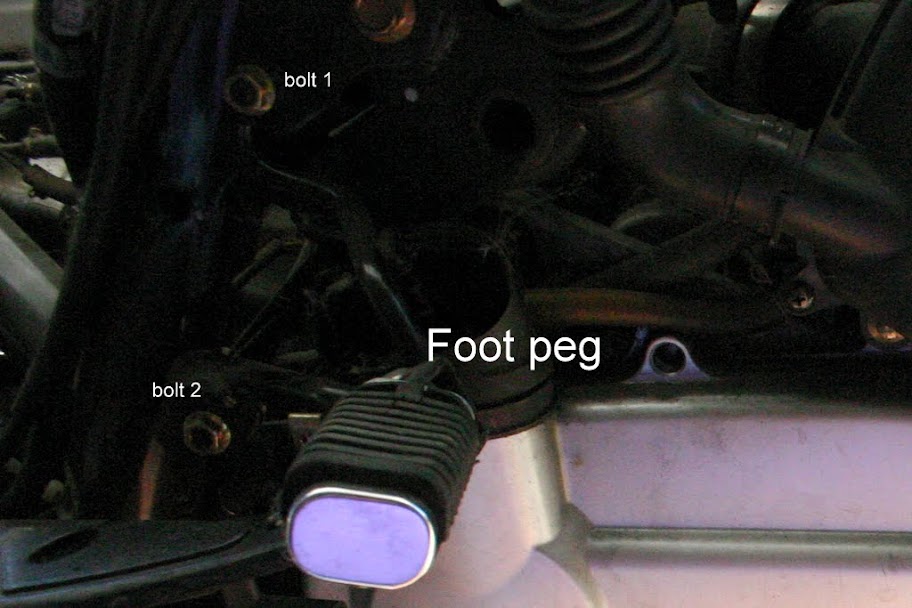

on my P250 (vintage, non-s) I need to remove all plastics from the back half of the bike.
If you go to the photo with this link and follow the image, if will show you how I take my plastics off.  You may need to move to the image of me removing the rear rack mounting screws.
http://picasaweb.google.com/guyharrison/ScooterPhotos?feat=directlink
After you get the plastics off, I need to take these bolts from the pillion foot rest off. I cannot take my CVT cover off without taking off the foot rest.

I hate the thought of pulling all this stuff off to get to this bolt so I can remove the cover.  No one with current ps250 has posted though - that means there is still hope.

sounds like 20 grams for me - I like the sound of shot out of a cannon - although my scooter already has real good acceleration compared to my 200 Aprilia which is kinda doggy (6 seconds to 40 mph from standstill).  I will order some next week and refer to pictures and info here when I go to  put them in.  One other question - when I tried to get my cover off the variator I could not get one on the bolts out - it was the one upper left (as I recall) - I could not get to it with the tools I have - anyone have a tip to get this one out?
You need to pull the body. S is NOT user friendly.
