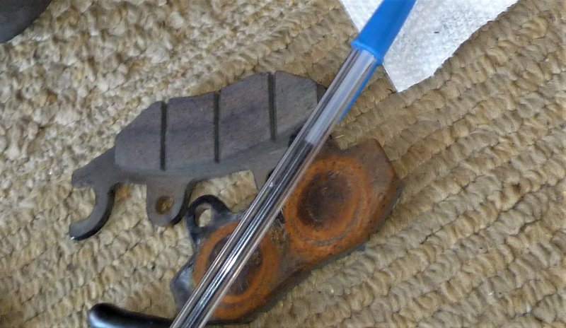

Today I received the first half of my order for the front brake pads from Amazon.
I had ordered a 2 pack of a pair of EBC FA630HH. That would be a total of 4 pads... 2 for each caliper up front where there is a caliper on both sides of the front wheel.
Amazon's price for this 2 pk item has been fluctuating between $84-$85 for a long time now and then on March 24 it dropped to just less than $48. So I put in my order. The next day it went up $10 higher and now is back to $84. It is a 2 pk with 2 pads in each blister pack. For some reason they were shipped separately so I received one blister pack today and the other still shows on the way.
I wanted to verify myself that these will work so I pulled a pad out on one side to compare and these are an almost exact match. I say almost because the pad material itself is one solid segment for the entire pad and the OEM pad has a few segments. The OEM configuration allows for better cooling but I think that will only come into play in doing a lot of hard braking. Otherwise these EBC pads are an exact match for size and shape and fit.
Pulling the front brake pads out to replace is a VERY easy task on the AK. There is a pad pin clip to pull out (can be done by hand!). Then the pad pin uses a 30 mm eTorx to remove. The pad spring pulls out easily and then the pads pull out VERY easily. Inserting everything is just the reverse. Since I had the pad pin out I sanded the little bit of rust off of it using an emery cloth and then lubed with Silicone grease. The brake pad replacement on these Brembo brake calipers is the easiest I've ever done on any bike or car... ever!
The Brembo FA630HH pads are a common item used on Ducati and BMW bikes so will be around for a very long time.
