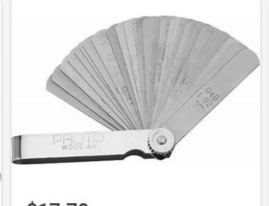

Not yet. I’m waiting for my valve adjustment tool to arrive before putting it back together. Thought I’d tinker with the muffler in the mean time.

« Reply #3 on: August 24, 2022, 03:30:05 PM »
What's a "valve adjustment tool"?.....the blade feeler gauge?
Re: Fix muffler?
« Reply #4 on: August 24, 2022, 05:54:17 PM »
I'm guessing one of the 'all in one' tools that holds the nut or adjuster and lets you move one without the other..?
