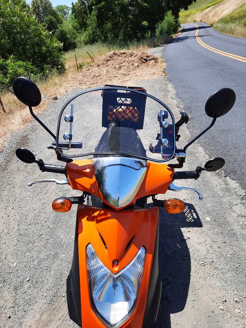

After my cool down break I took another go at it.
I have it mounted now but I digressed a bit from the GIVI instructions to get a better fit.
I now need to go back and look at it in the daylight.
Light was not advantageous for taking pictures at midnight  :(

Modifications to the Givi instructions:
1) I used the US turn Signal pods in place of the Givi spacer to attach the upright bracket to the bottom of the brake master cylinder. Those pods have a stem that is 5 to 6 mm shorter than the Givi Spacer. The pod stem has a tab that aligns the turn signal to the master cylinder. Thus a spacer can not be used between the top of the stem and bottom of the master cylinder.
2) I installed the windshield to the left and right upright brackets. I snugged those fasteners down but with just a tad free movement. All the other fasteners were left lose. Then I tugged, twisted, slid and otherwise manhandled the windshield into what seemed the best alignment. Then I tightened all fasteners in place.
Repeat step 2 as required ....  :-\
I still need to go back and make some fine adjustments and lock-tite (blue) everything into place. The windshield is a a bit taller than I had hoped. The seems to be just a bit higher than my helmet. I may go back later and trim 150 to 250 inches mm off the top. I am not overly impressed with Givi's solution for the mirror mounts. I will post high res pictures to my web site later today. This old fart needs to take his morning nap.

I bought this from Amazon for my Like 150i. Works well.

I installed this on my Like 150i with no trouble.  Works well.
https://www.amazon.com/gp/product/B00T6JK3YE/ref
Looks interesting but I have now have time and money in the GIVI ... I am gonna make it work !
I got the Givi because of the name brand (foolish) and it was the only one specifically design to fir round the unusual shaped headlight. I think that I want to apply some 'tinting' to the back side as well. Also thinking about adding Cell phone and GPS holders.
