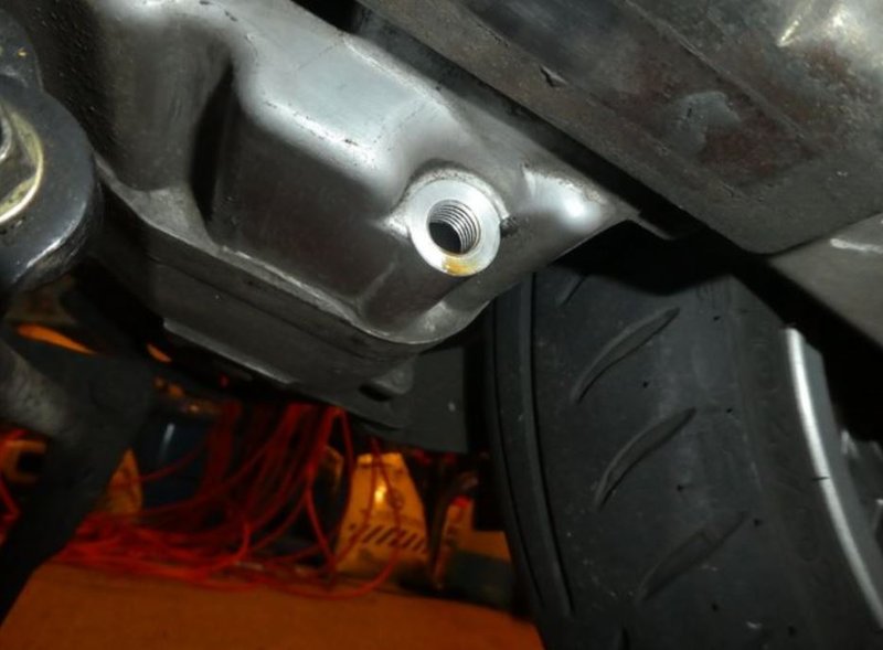

The LIKE200i requires less than a qt of oil.
Alum. washer sandwiched between blue teflon, fits the 17mm drain plug nicely - made for Toyotas.

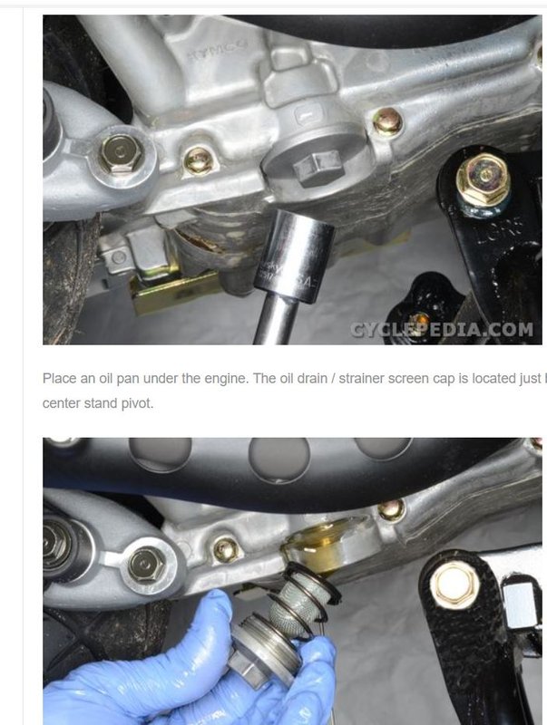

I don’t even recall what Kymco recommends for an oil change interval?...I’m sure 1300 miles on that full synthetic is nothing. I like to see where you’re draining oil from, too. On my S200 (same motor minus fuel injection) I drained it many times just from the oil screen…only after I disassembled my motor did I see that the real drain plug drained much more oil. Just draining from the screen left quite a bit of oil behind.

Yeah, cyclepedia says to change the oil like this....but I prefer to not mess with the large soft metal 'nut' on that thing. I haven't found anything in that screen in a long time.
On the other side of the scooter I open this 17mm plug to drain the oil. If there's some oil still in there - and there is - I don't worry about it.

here's an internal engine view of your drain plug..it sits at the low point of the motor.
Interesting!
Thanks Hawk.
