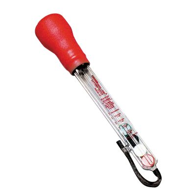

Try a hydrometer test if you can get at the cells. One like this should be sufficient. You can find them at any auto parts store.

kawzak
  • Posts: 127
Re: Complicated battery issue. Is it dead or not?
« Reply #2 on: August 23, 2008, 01:42:56 AM »
