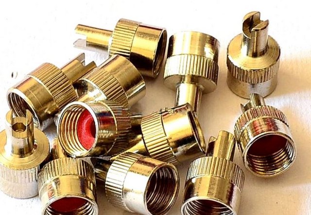

Remember the black plastic tire valve caps -----turn it over and it became valve/stem core removal tool.
Also....there are tire valves which can be installed outside the rim - without removing anything but the old valve stem.
I'm running one in my Liberty's back wheel. Holding air just fine for a couple years now.
or these....
or these....
I do remember those caps. Have had them on a bicycle once. My AK has plastic caps similar to that. The valve core removal tool is recessed into the end of the cap. Screw it on one way to seal the valve. Turn it over to remove the stem core.
