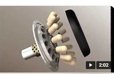

Fellows, a J Costa doesn't have rollers...it has pins. It is a very expesnive alternative to the stock Kymco CVT set-up with roller weights.
Re: JCosta IT619PRO
« Reply #5 on: July 11, 2022, 12:34:44 AM »
Several videos on youtube shows both how the J Costa works and how the pins wear the holes! Flat spots on rollers and sliders that flip seems minor since rollers and sliders are fairly cheap to replace. The main machined part on the J Costa wears out....!
