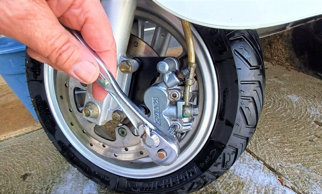

Crazy easy to change the oil in a LIKE200i.
Used the last of my Castrol and a Toyota washer.

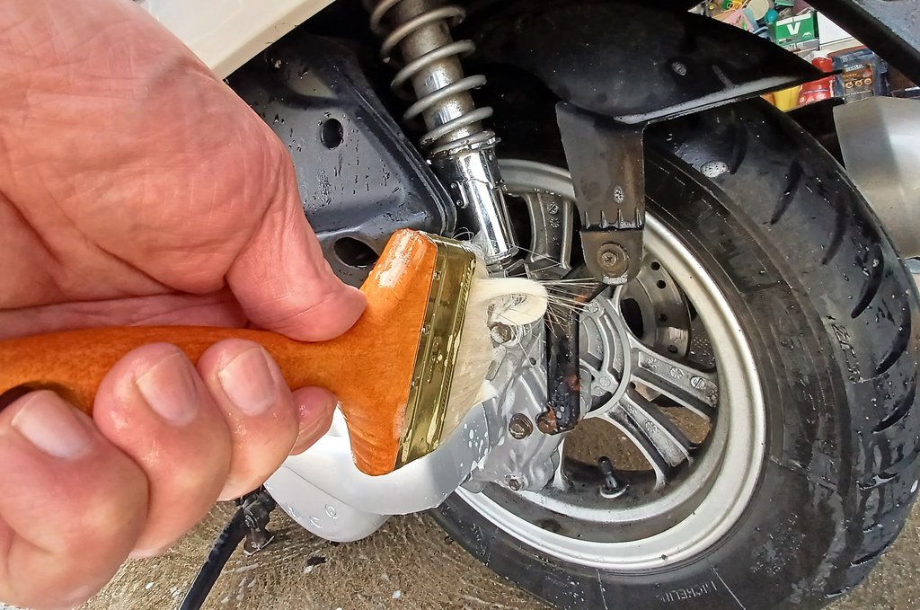

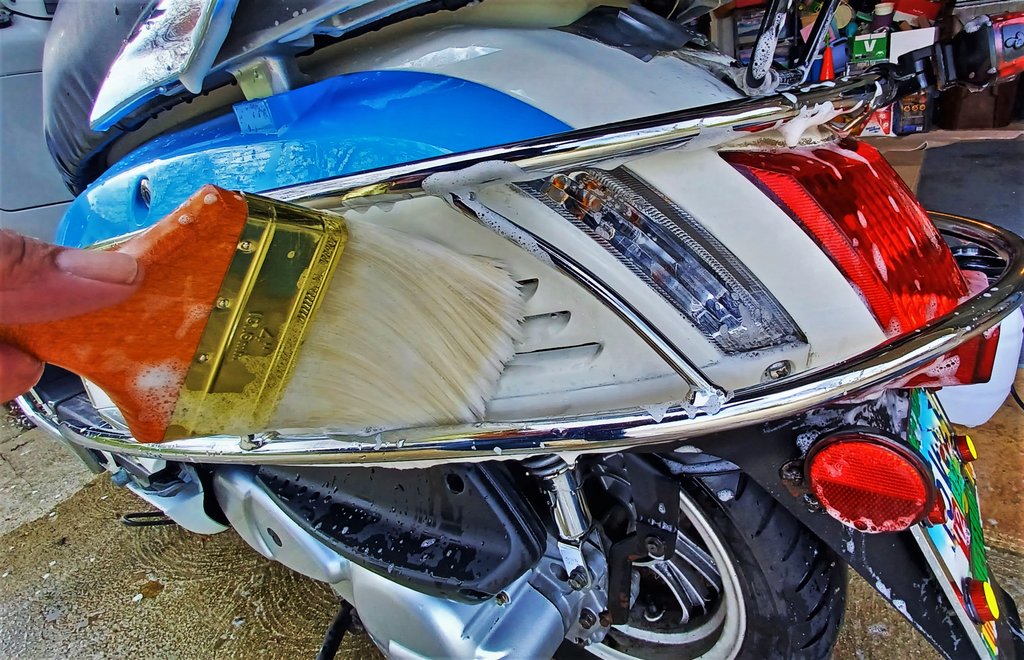

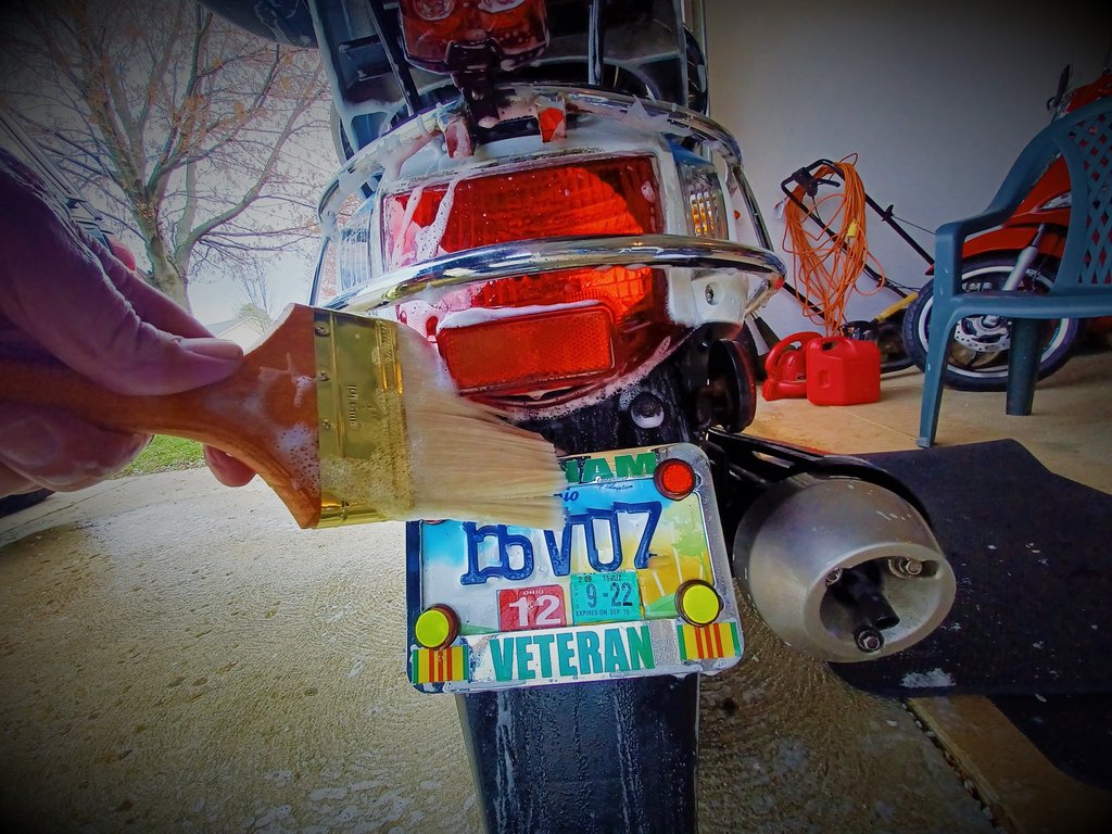

Then sprayed orange degreaser up under things...let it soak then went after it all with sponges and brushes.
A soft long bristled house brush works great for getting into all the nooks and crannies....shock springs and wheels !
While I'm down here crawling around I empty the puke toob, check the brake pads and re-set the slide pins so they don't freeze up. (the braided brake lines which Kymco used on these scooters is a deluxe feature ! AMAZING brakes on these scooters!)

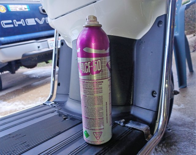

After it's dry - apply ACF-50!
