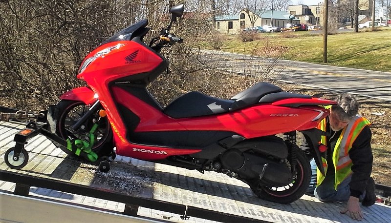

Rear, Mar 2015, Honda Forza300, Dunlop ScootSmart sliced by metal, required tow and new, up-sized, Pirelli, at the dealer. (No correct size in the USA.)  My afternoon ride was just a touch over $500 - for tire, installation and tow to the dealer. (obtained better road ins. after this!)

* used the kit shown on the LIKE & the Liberty. Honda tire was sliced open - required a new tire.
