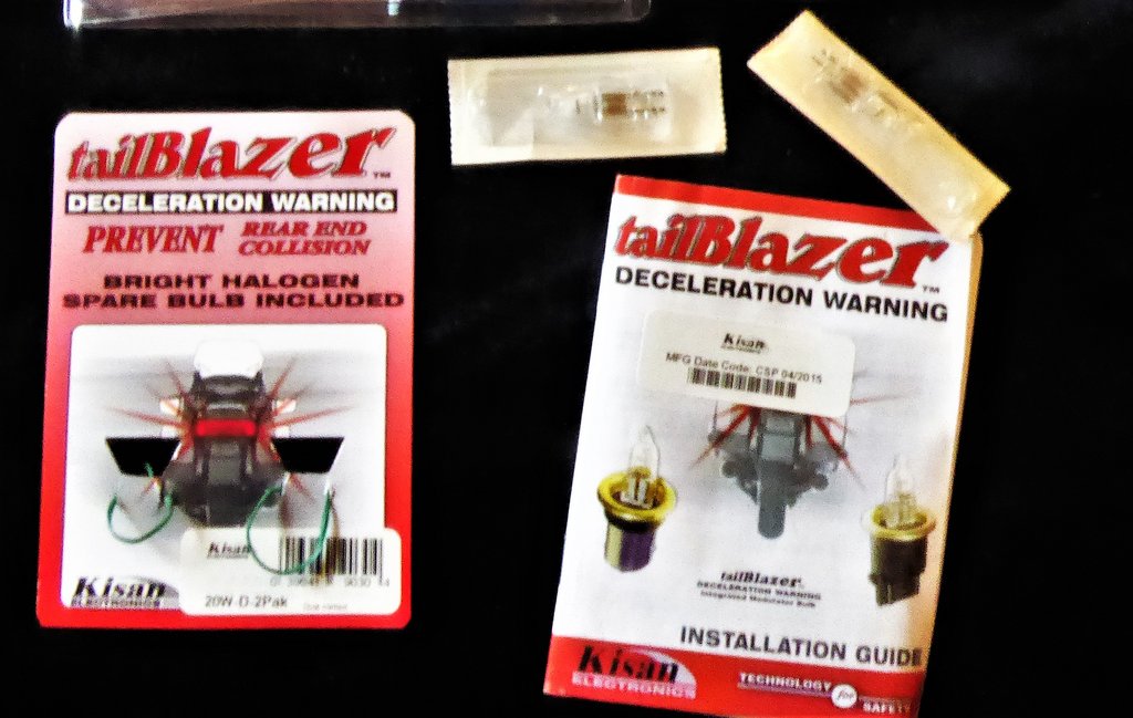

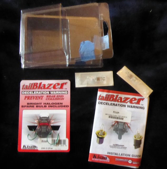

sure - the plug-and-play, plug-in bulb is easy. I went that way.
I went out and found the old package of the bulbs for my Burgman in my parts drawer.
There are videos to show how they work. They blink a few times as you touch the brake lever and then settle to a full on after a couple seconds.
What bulb to use? >> match the bulb type you have in your scooter. Remove it, install the new TAILBLAZER bulb. No messing about - the bulb base has a gizmo in it to make it do the pulsing thing. Cheap?...no - but it works great and comes with a spare bulb (which as you can see I never needed to use -guess I forgot to give these spares to the new owner :)
I DO recommend the Halogen version over the LED version. The halogen works better in almost all reflectors - than does the LED. Halogen looks much brighter!
Ebay and amazon for the part - or you can try to wade through the Kisan trailBlazer web site.
Just match your scoot's bulb type/number ....buy it and plug it in!
I bought the two-bulb packet for the Burgman's twin brake lights. They do their thing simultaneously.
Honestly don't know why guys go through any other system - these things work great.
