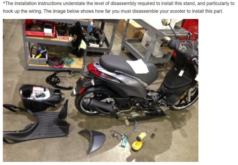

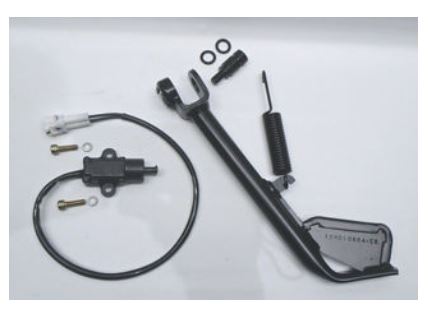

A side stand was an "available accessory" for my Piaggio Liberty.  @$50.
 Installing the bugger was a pain - but I use it all of the time now. It came ready "wired" to attach to a socket within the scooter to lock out a start if the stand is down.
I did NOT hook up the ignition cut-out! I do not need one more thing which can play up and keep my scooter from starting on a cold winter day miles from home!
This is posted by the parts dealer in Texas.... :) ;)
No thank you....!
