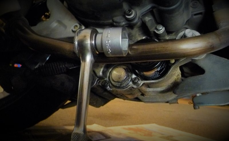

"What's your father fussing about out there in the garage?"
"Says he hates Italians.....?"
"He must be changing the oil on that red scooter again."
the fill hole is tiny on the Piaggio Liberty - a 45min job to top up!

Filter and drain blocked by exhaust pipe? Where fill hole?
Nah, filter and drain aren't a problem. Best to keep it on side stand to keep the oil off of the center stand.
. A #2 pencil would barely fit the tiny fill hole.
Funnels make it overflow.
I use a syringe with a piece clear fuel line. Pour oil in the syringe....let it slowly drain into the engine. Do this for 1.5 Qts.
Fortunately, I'll forget how much I hate it before starting the next oil change.

That’s Italian design flair Stig! A triumph of form over function.
