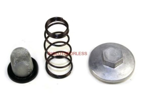

I never use a torque wrench for such small fittings.
Use a good washer, if there was one originally - and just snug it with a 6>8" ratchet.
Snug is all you need. Too many have stripped the case.
If your scooter has a large threaded cap on the bottom of the case - that will have a spring and a screen which gets cleaned.
something like this....
Consider purchasing a cyclepedia.com service manual?

Thank you both for the replies.  I found the screen plug and will change the oil again in about 400 miles to check the screen.
