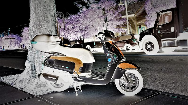

Hope to enjoy this scoot for a long time. Really like the style and am planning to ad the fron & rear chrome bumpers and a windshield. Attached are a couple photos...one, simulated xray, the result of a photo app on an iPad.
